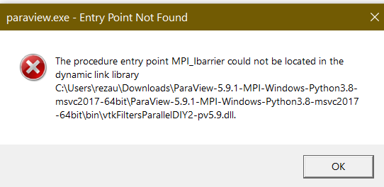

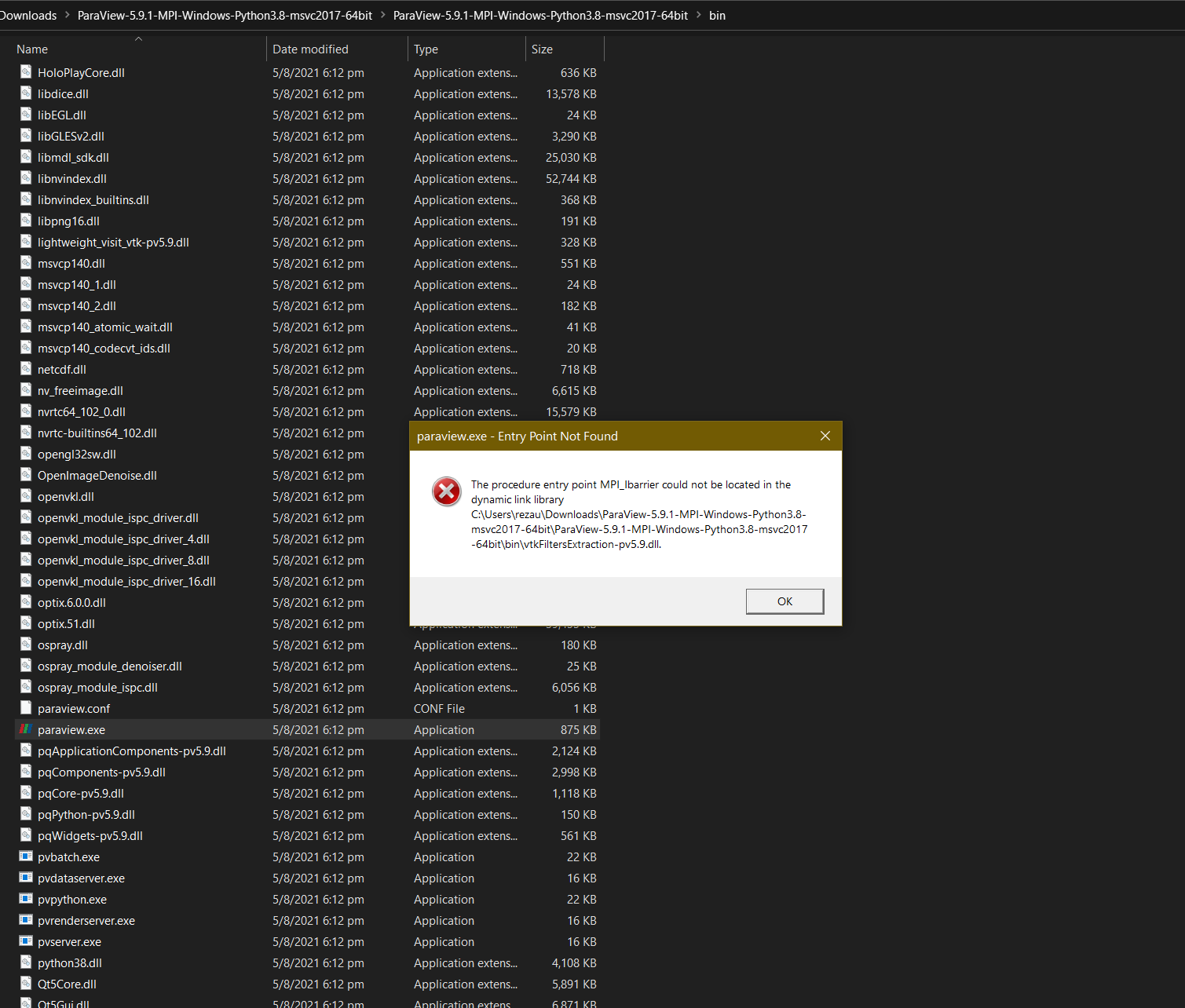

5.9.1 MPI shows these errors when I try to open it:

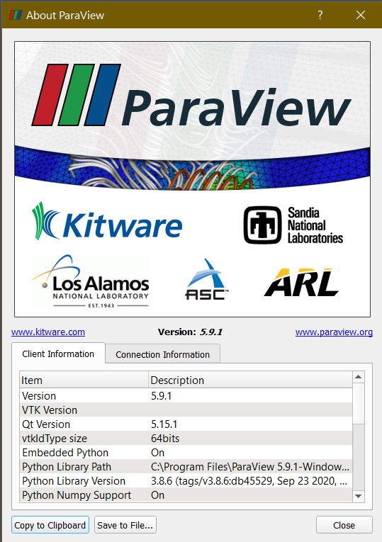

Client Information:
Version: 5.9.1
VTK Version:
Qt Version: 5.15.1
vtkIdType size: 64bits
Embedded Python: On
Python Library Path: C:\Program Files\ParaView 5.9.1-Windows-Python3.8-msvc2017-64bit\bin\lib
Python Library Version: 3.8.6 (tags/v3.8.6:db45529, Sep 23 2020, 15:52:53) [MSC v.1927 64 bit (AMD64)]
Python Numpy Support: On
Python Numpy Path: C:\Program Files\ParaView 5.9.1-Windows-Python3.8-msvc2017-64bit\bin\Lib\site-packages\numpy
Python Numpy Version: 1.19.2
Python Matplotlib Support: On
Python Matplotlib Path: C:\Program Files\ParaView 5.9.1-Windows-Python3.8-msvc2017-64bit\bin\Lib\site-packages\matplotlib
Python Matplotlib Version: 3.2.1
Python Testing: Off
MPI Enabled: Off
Disable Registry: Off
Test Directory:
Data Directory:
OpenGL Vendor: NVIDIA Corporation
OpenGL Version: 3.2.0 NVIDIA 471.41
OpenGL Renderer: NVIDIA GeForce GTX 1070/PCIe/SSE2
Connection Information:
Remote Connection: No
