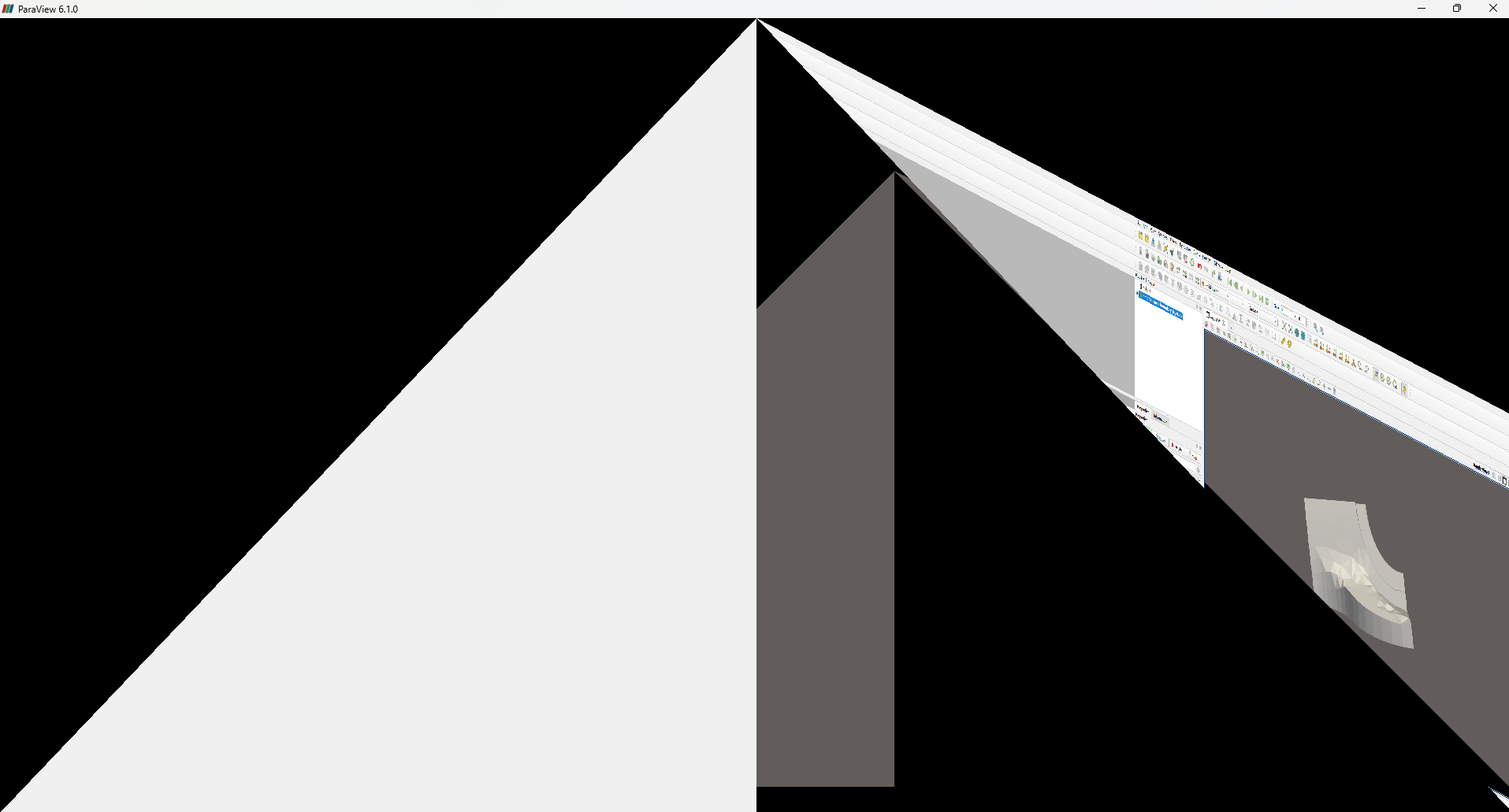

Hi, I have encountered a similar problem.
After I update my graphic driver, the main GUI cant render in right way(picture above).

Please see the discussion about this particular driver here: ParaView not working with NVIDIA driver 595. NVIDIA says they have fixed it in their driver release expected today (April 28).
thank you! it fixed well!
