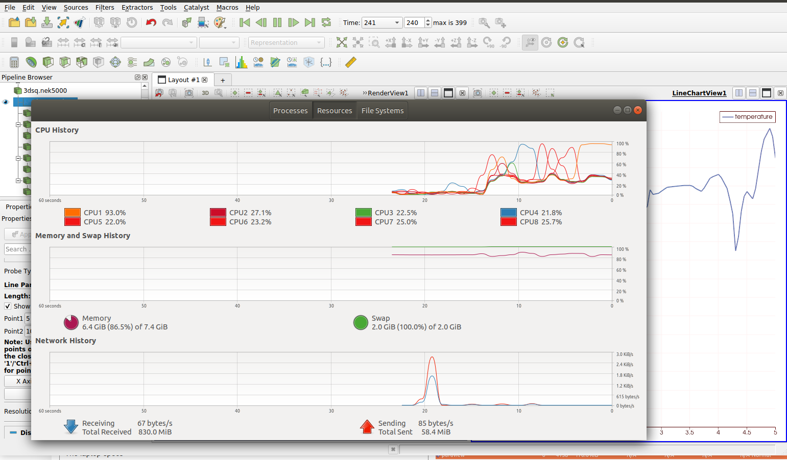

This is the memory usage when the processing take place:
You think I could running out of memory here Alan?
Yep. that would be my guess. Again, in ParaView, in the View menu, run the Memory inspector.
This is how it looks now:
But the moment I add any kind of command (say: plot data) it freezes and exits out!
In the system monitor it shows a sudden bump in memory usage, that is strange, does performing such command can cause that memory usage that the system can’t handle?
