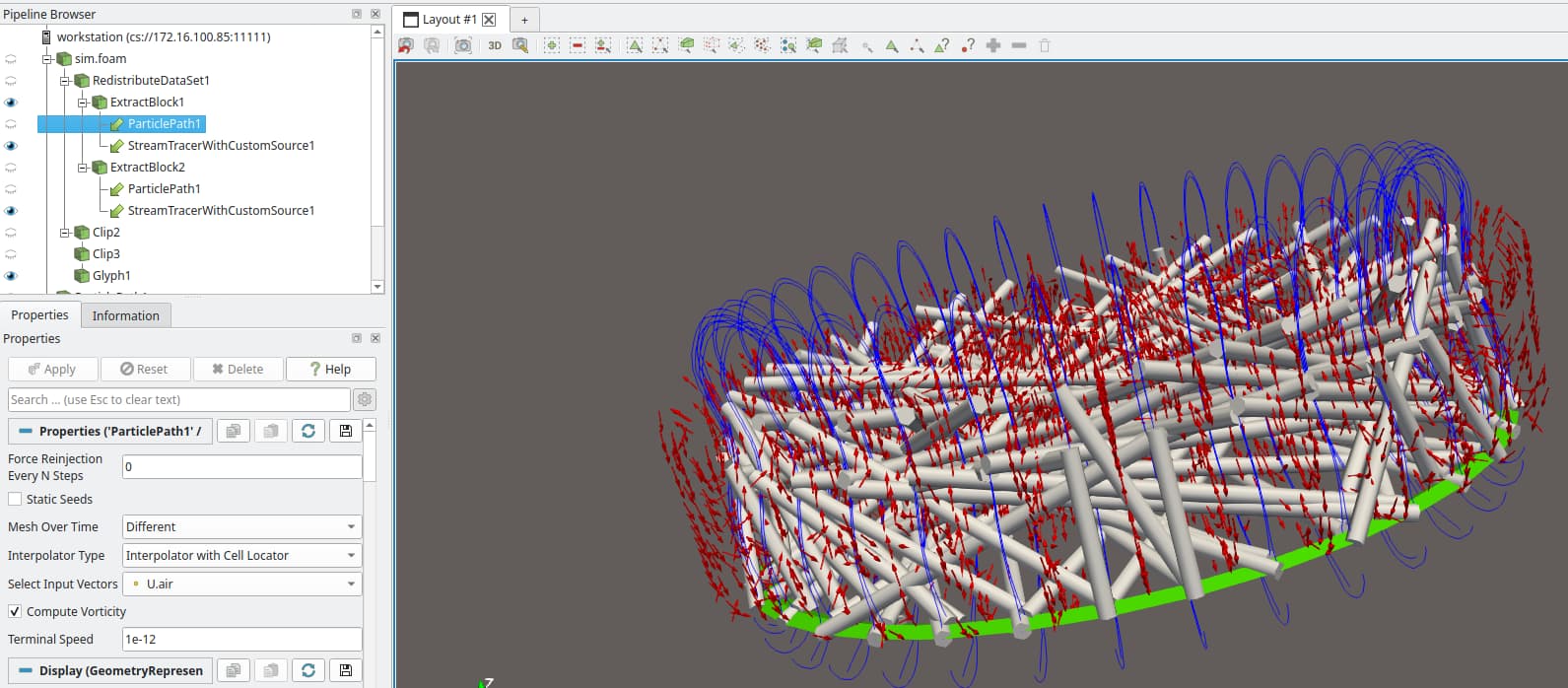

i have a multiphase simulation in OpenFOAM and would like to use particle path over it.
I wanted to recreate the same workflow as stream line from custom source but i am getting really wrong results. I am using as vector U.air and here one can see 3 filters displayed at time step =1:
in green: the point source from where the particle & the stream lines come from (seed source)
in grey: tube filter over the particle path
in blue: the stream lines with using same field (U.air) and same seed source as the particle path
in red: a gliph of the cliped section with direction following U.air but not scaled.
as it can be seen nor in the gliphs nor the stream lines, one can see a rotational movement (and I can confirm that this is what expected)
nevertless the particle path (grey) looks like it is rotating (and a lot), but i think from seeing the other filters that might be an issue of association from point a to point b? between each time step?
I am missing something? or i am doing something wrong? (i can not share the data sadly)
