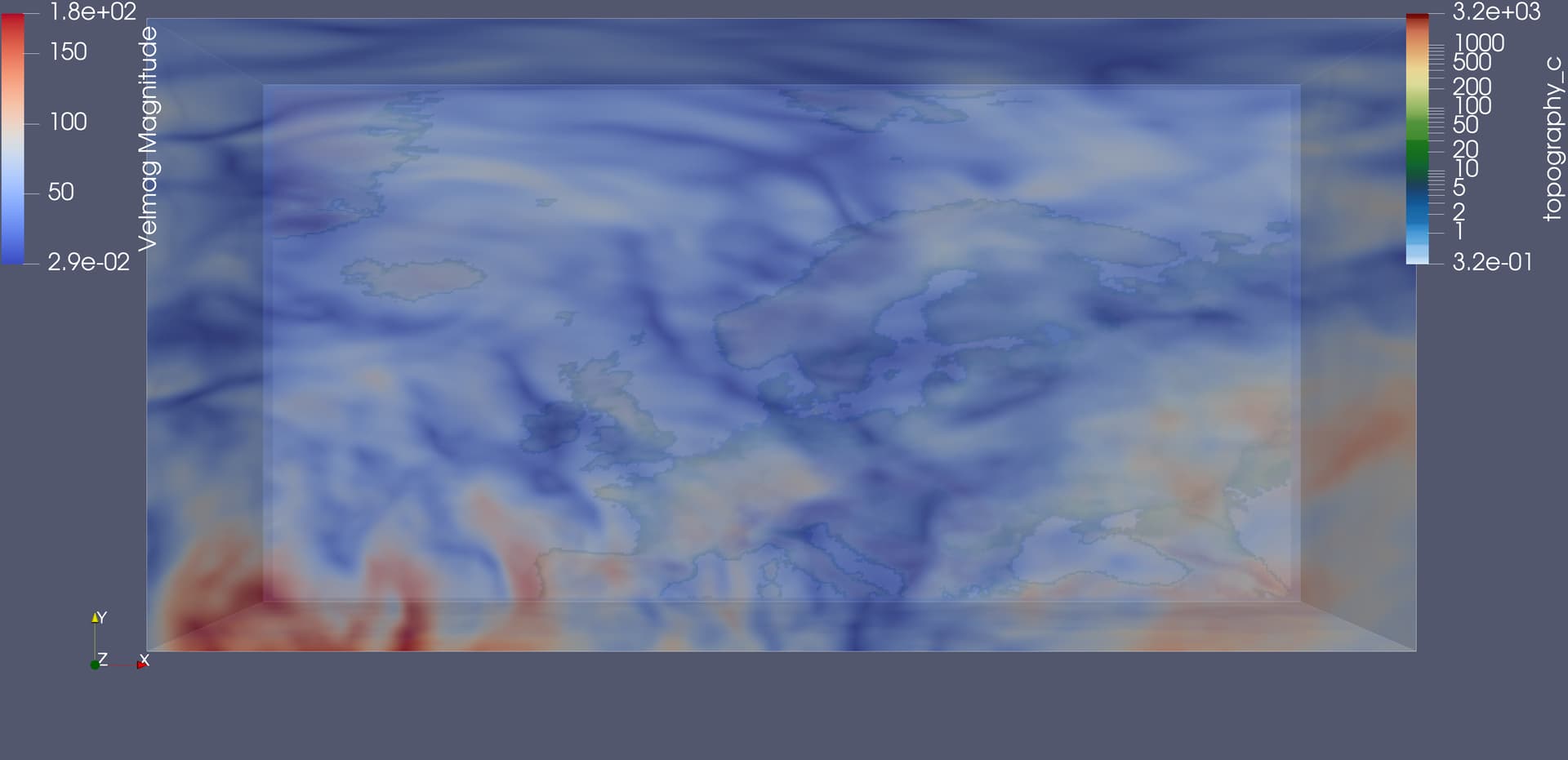

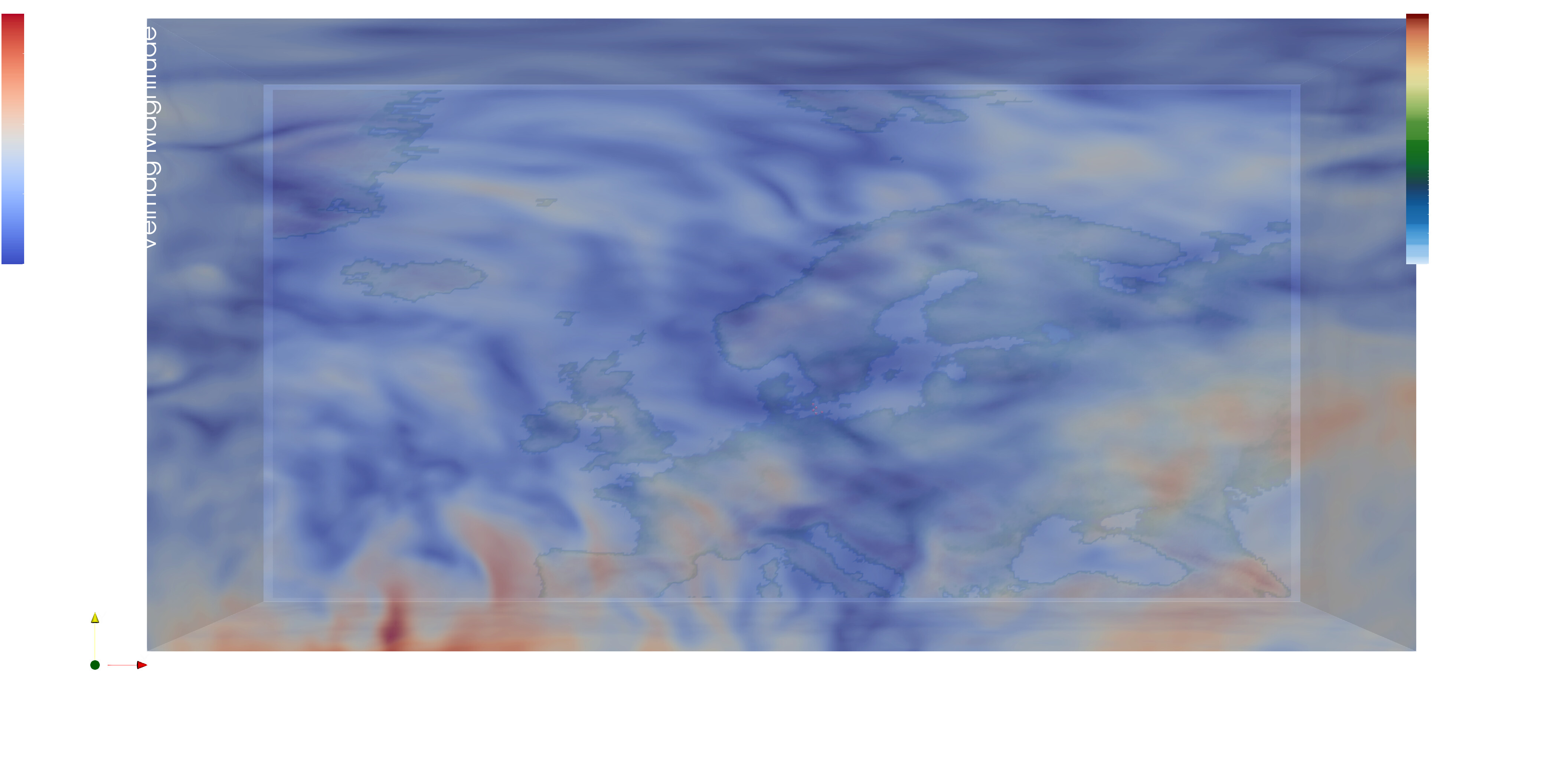

Step 0 (The injected points are grey and the tracer particle purple - above baltic sea)
Step 1 (Here only the grey points are visible at origin but the purple points disapeared)

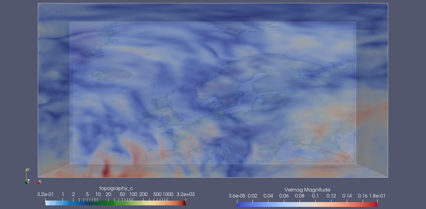

Your points are going out of domain right away because your velocity is too high.
Divide the velocity vectors to obtain a beter results.

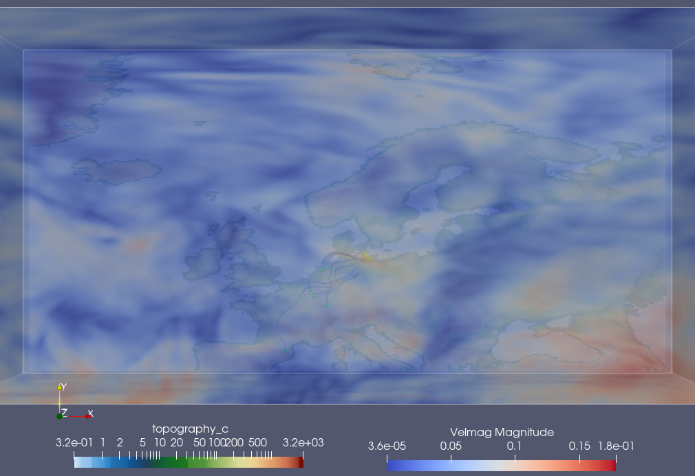

Here i’ve divided the velocity by 1000 in your calculator to get this result:
Thank you very much. The result looks great, I couldn’t check it out yet (visualization is not my only task :face_with_spiral_eyes: ).

@mwestphal It works with the adjusted velocity.
