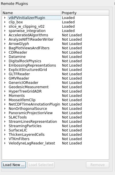

Before the plugin has ever been used
Paraview5.8.0.ini:
[PluginsList]
Connection1%3A\installs\paraview\5.8.0\bin\paraview="<?xml version=\"1.0\" ?>\n<Plugins>\n [a bunch of standard plugins]</Plugins>\n"
Plugin Manager:
Loading with PV_PLUGIN_CONFIG_FILE set
Paraview5.8.0.ini:
[PluginsList]
Connection1%3A\installs\paraview\5.8.0\bin\paraview="<?xml version=\"1.0\" ?>\n<Plugins>\n <Plugin name=\"VelodyneLagrangianXDMFReader\" filename=\"/some/path/to/VelodyneLagReader_latest.py\" auto_load=\"0\" />\n <Plugin name=\"VelodyneLagrangianXDMFReader\" filename=\"/some/path/to/VelodyneLagReader_latest.py\" auto_load=\"0\" />\n [a bunch of standard plugins]</Plugins>\n"
Plugin Manager:
Notice how the plugin is listed twice in the .ini file as well as the plugin manager dialog
Then loading with PV_PLUGIN_CONFIG_FILE unset
Paraview5.8.0.ini:
[PluginsList]
Connection1%3A\installs\paraview\5.8.0\bin\paraview="<?xml version=\"1.0\" ?>\n<Plugins>\n <Plugin name=\"VelodyneLagrangianXDMFReader\" filename=\"/some/path/to/VelodyneLagReader_latest.py\" auto_load=\"0\" />\n [a bunch of standard plugins]</Plugins>\n"
Plugin Manager:
Notice how the file is listed only once in each location.
(The name updates to “VelodyneLagrangianXDMFReader” once loaded)
