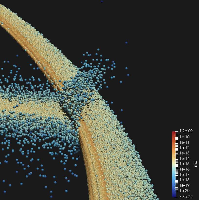

I have raytraced many particle datasets in the past with great results. Up until ParaView v6.0, I used to compile ParaView with OSPRay v3.1. I don’t use materials, only scalar field coloring.

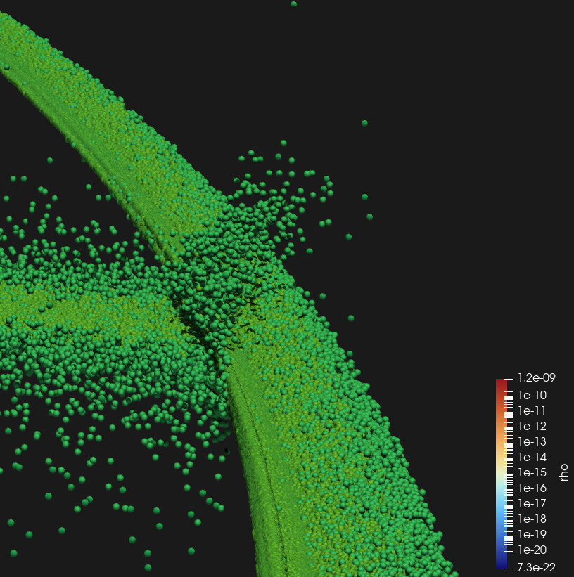

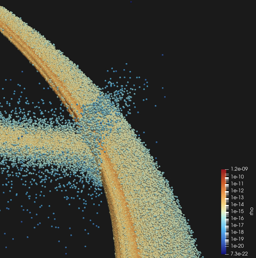

Trying ParaView v6.1, I made an attempt to switch to OSPRay v3.2, but my colors are wrong (all greenish). I am including an OpenGL rendering as reference to show the whole scalar range of my particles’ field (note that I use logarithmic colormap scaling). My raytraced image (with shadows) with OSPRay 3.1 is good and my last option is unfortunately all green…
Have other users out there seen similar color defects?

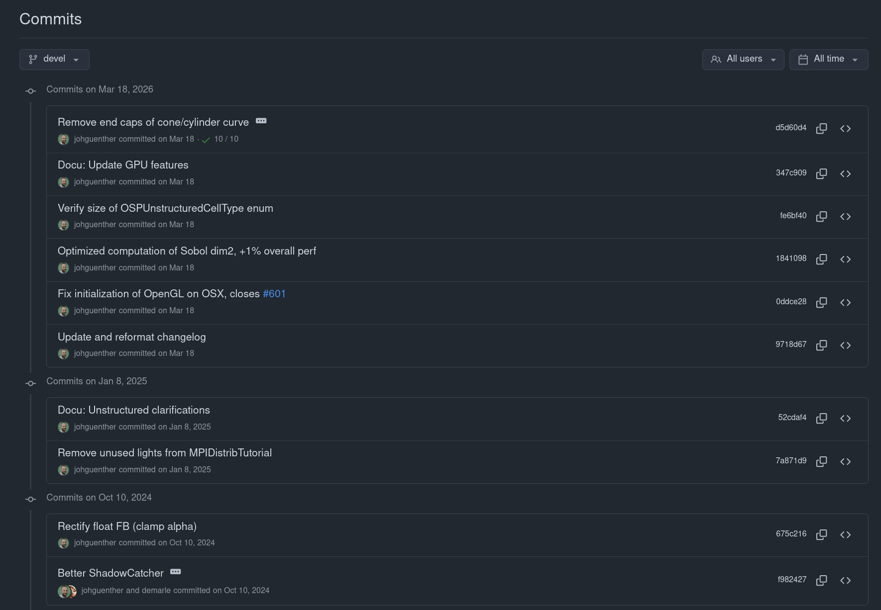

I would also like to emphasize the Intel change policy regarding OSPRay right in the middle of OSPRay 3 roll out, the repo is hardly maintained now.
