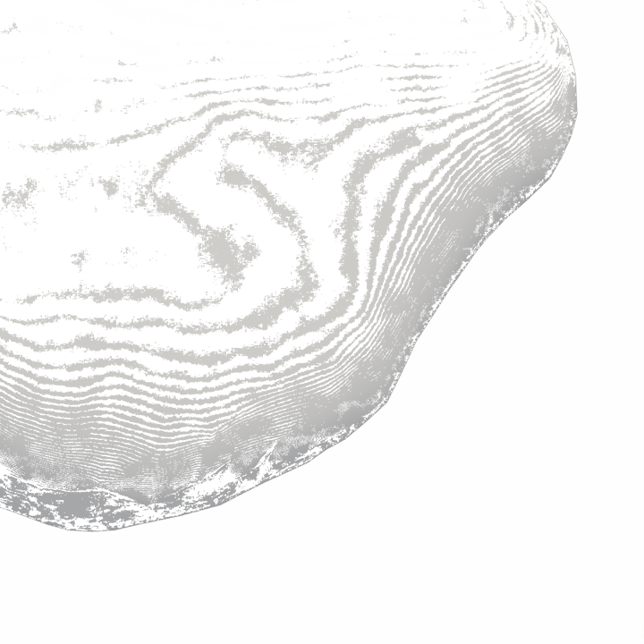

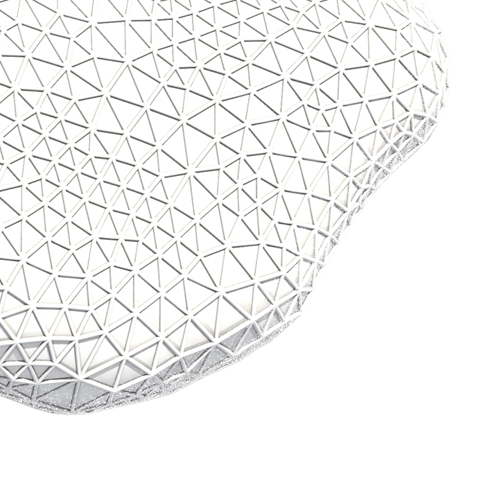

I have problem when rendering mesh wireframe with transparent background using OSPRay raytracer. If image is rendered with background everything is rendered correctly, problem appears when setting transparent background. Here is an example:
Am I missing some general settings to fix this problem?

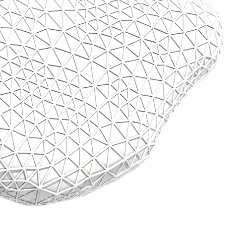

Wireframe - surface overlay using OSPRay raycaster:

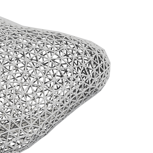

Using OSPRay pathtracer it gets even worse:
Both background mode:
Backplate mode:
Hi timothee,
Yes, I am saving screenshot using transparent background option. As you can artefacts are appearing using both OSPRay raytracer and pathtracer.
I am using Paraview 5.9.1. for mac. I haven’t build it myself.

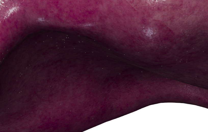

Maybe I should open new topic for this, I came across another bug when rendering textured mesh using ambient occlusion. Missing/transparent pixels present also with increased SSAO number of samples and blurring of ambient occlusion. Here is an example:
I have created state file to reproduce this with wavelet source.
wavelet_example.tar.gz (870.5 KB)

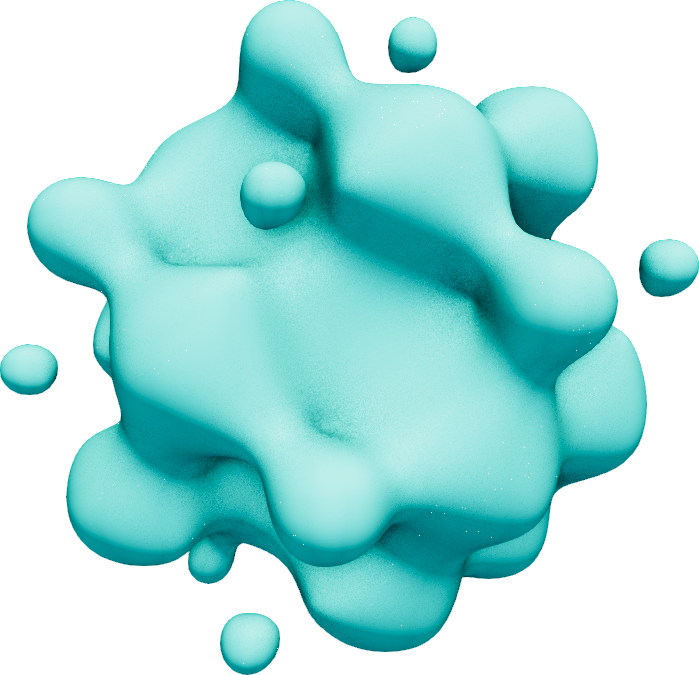

Render of wavelet isosurface using default scivis backend and AO on:
