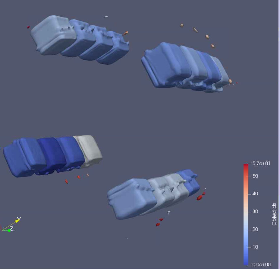

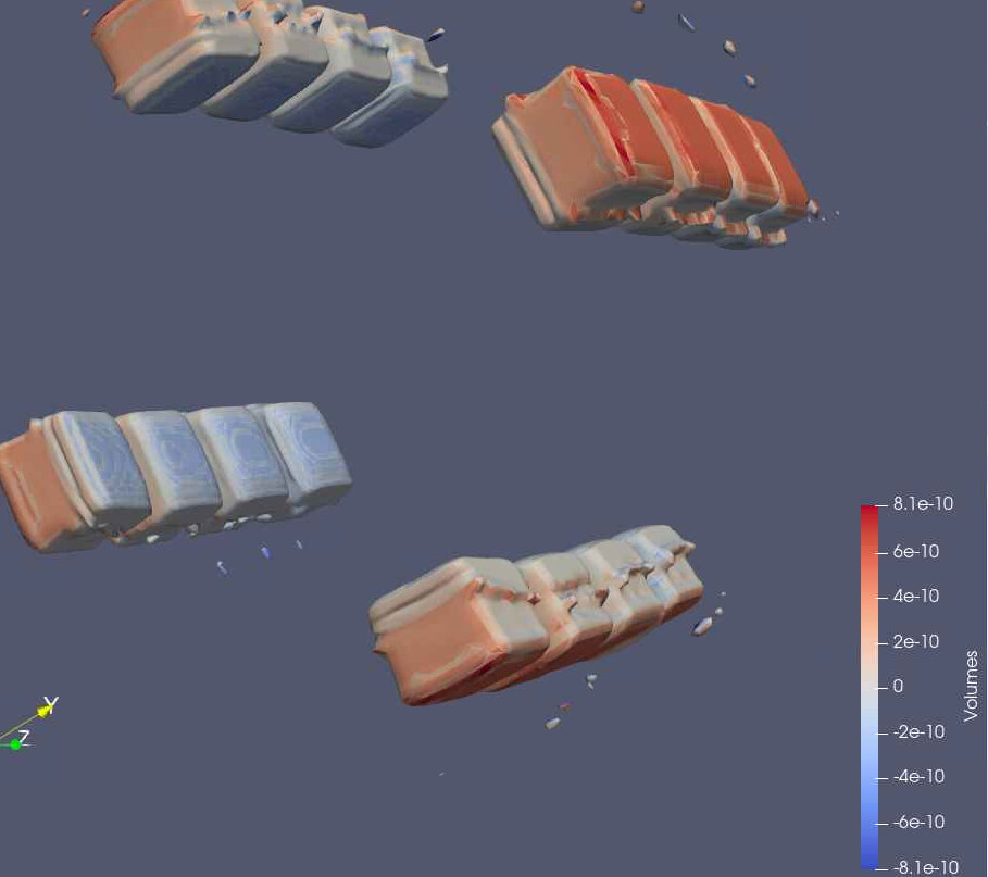

Perhaps I’m misunderstanding what this filter is supposed to be doing? I would have expected all the connected objects to have the same volume. This is what I get, instead:
ObjectIds seems to be getting it right. Am I supposed to manually sum on the different Objects? I’m also not sure where the negative volumes are coming from.
