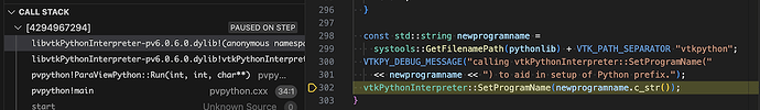

It does. Tracing through on my Mac, I see
That doesn’t seem to be a mac-specific code path, however.

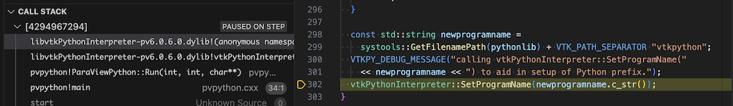

This is the default path. Note that newprogramname is always constructed with vtkpython right above the breakpoint location.
