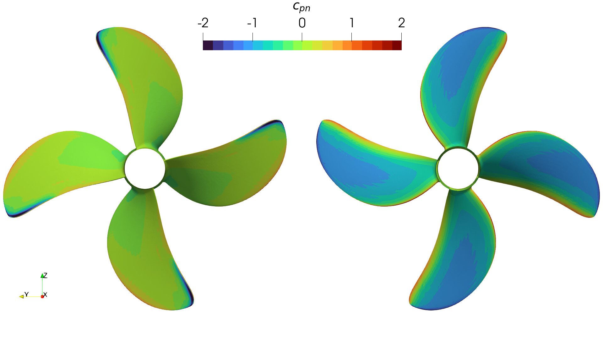

pvbatch: first screenshot empty, second is as it should be

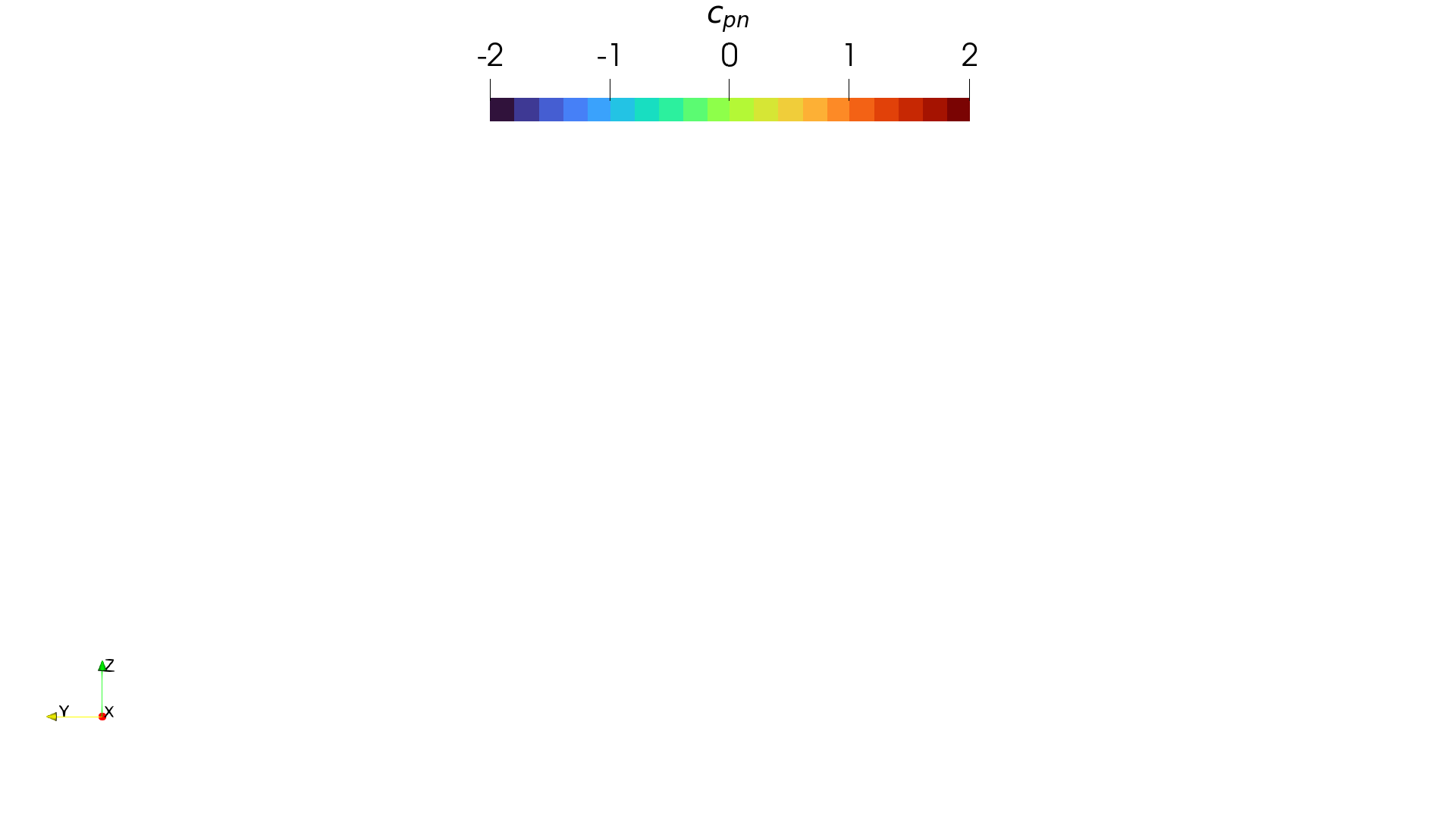

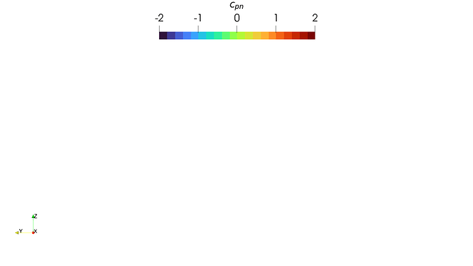

I am using Paraview 5.13.3 (on Windows 11) to generate a large number of plots with pvbatch. All work fine, except a limited set of plots. In the script, the first plots is empty (except for a color bar), the second is ok, and the third is empty again. I have no idea why this is happening and how to fix it. I tried Render(), .UpdatePipeline() but to no avail.
I made a simplified version of the script that reproduces the problem, but now with two plots. The first one fails, the second one is ok. Only thing in between is that I set a display option (to a value that it already had). Why is this happening, and is this an error on my side, or a bug?
I tried several alternatives, but it seems the only work-around is to save the screenshot twice. In the current script, it works if a Render() is inserted before the SaveScreenshot, but in my original (more complicated script) that did not help.

Hi Serge, thanks for providing the script and data. I reproduce what you see on my Mac with ParaView 6.0.0-RC3 and 5.13.3.
If I add Render() before the first SaveScreenshot call, I get an image as you are expecting in the first plot on both Mac and Windows versions of ParaView 5.13.3 and 6.0.0-RC3. I know you said that didn’t work, but it seems to work for me.

Dear Cory,
Yes, with Render() it works with this script. However, this script is based on reading a datafile that was generated by a more advanced (and quite long) script. If I execute that one together with the screenshot, I get nothing, even when using Render() or UpdatePipeline(). So my only solution is to do the SaveScreenshot twice.
I assume this is not intended behaviour and normally, Render() is not needed before SaveScreenshot. So is this a bug? If so, shall I report this as an issue?
