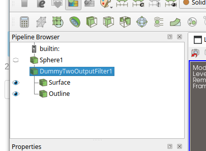

A workaround is to use @smproperty.xml since the <OutputPort /> is not a hint and hence @smhint.xml has no effect.
@smproxy.filter(name="DummyTwoOutputFilter", label="Dummy Two Output Filter")
@smproperty.xml(xmlstr='<OutputPort index="0" name="Surface" />')
@smproperty.xml(xmlstr='<OutputPort index="1" name="Outline" />')
@smproperty.input(name="Input")
@smdomain.datatype(dataTypes=["vtkDataSet"])
class DummyTwoOutputFilter(VTKPythonAlgorithmBase):
