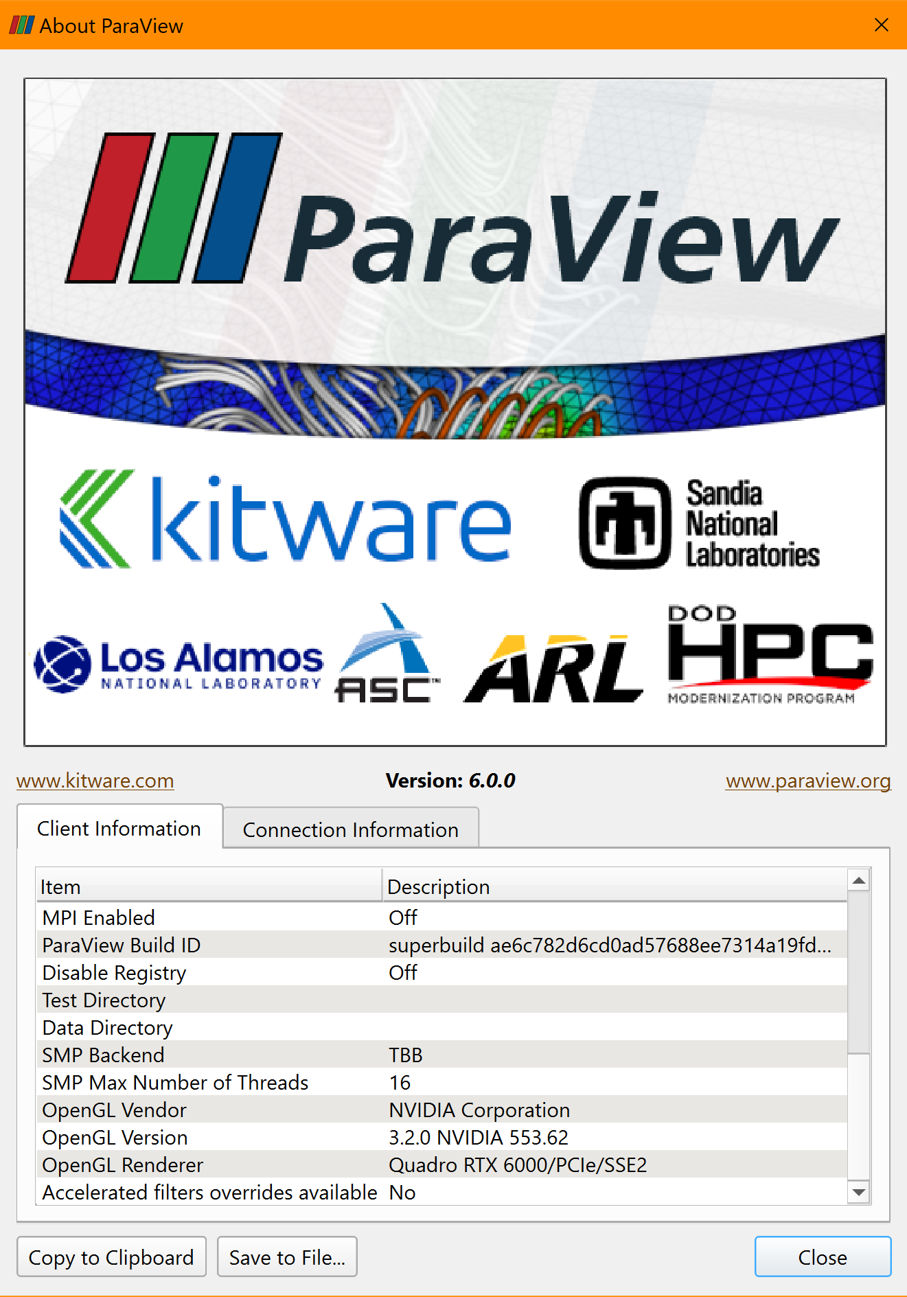

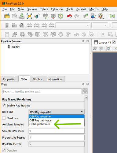

if you download and use the binary builds of ParaView you should have all the components to enable ray tracing on NVIDIA RTX GPUs.
If your system is capable, the option “OptiX pathtracer” will automatically appear under Ray Traced Rendering / Back End.
This mode will render any kind of surface geometry using ray tracing, to simulate advanced lighting effects like reflections or refractions in real-time.
If that does not work out-of-the-box, please check your log for errors. Updating the graphics driver is the first option to try.

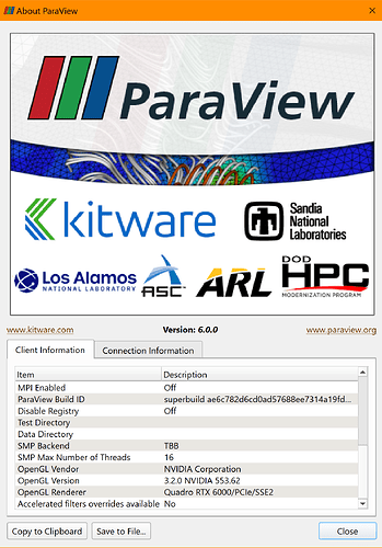

Do you have another GPU in your system? In that case, check the Windows Graphics settings. You can assign the NVIDIA GPU as the default graphics processor to your ParaView installation. To verify, the NVIDIA GPU should be listed in the ParaView About box. This can help to resolve graphics conflicts between multiple GPUs.
