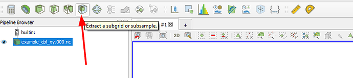

In ParaView 5.x version, I frequently used the “Extract a subgrid or subsample” filter from the toolbar as shown below:
However, in ParaView 6.x, that icon has been removed.
How can I restore it?
