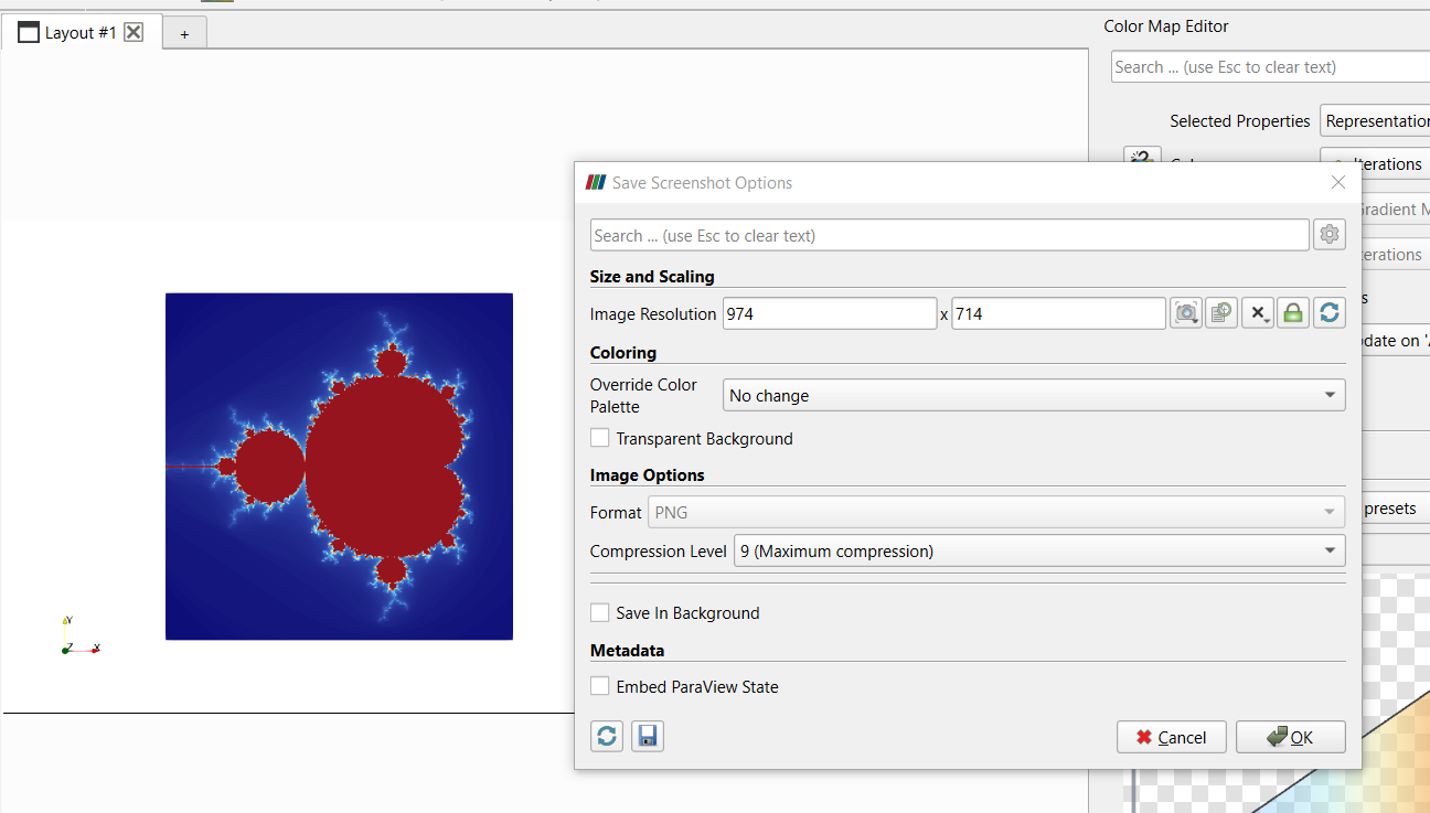

in ParaView 6.0.1 running on Windows 11 I have a problem with the Save Screenshot functionality when the saved image is of JPG type. It appears that the image format is not recognized properly as JPG.
How to reproduce?
  • ParaView GUI:
    • Setup a render view
    • File → Save Screenshot
    • The “Save Screenshot Options” menu will look like this:
    • Note that under “Image Options” the format is set to PNG and png-specific option “Compression Level” is shown

    • Note that Quality = 90 is not accepted as valid parameter as it is only expected if the image format is JPG and latter apparently is not properly identified from the file name test.jpg.
