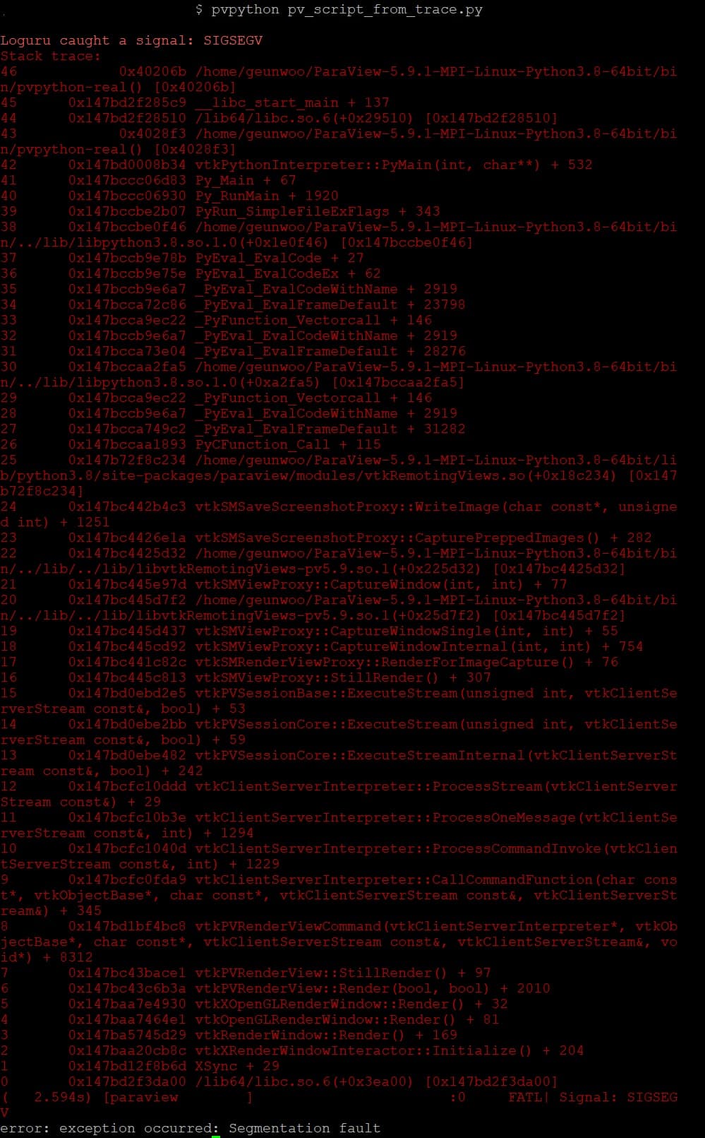

I used the following command,
$ pvpython pv_script_from_trace.py
When I’m using this one in linux system, attatched segmentation fault occurs
Probably, the error occurs at ‘SaveScreenshot’ part in line 139 of python code.
Why is it happen? Can anyone help me to solve this problem?
Do you have X running or are you running it via ssh or via schedule job?
Thank you for reply.
I’m running at terminal connected by ssh.
Then that explain why.
Long story short, ParaView depend on OpenGL and we depend on X, EGL or OSMesa to provide us the graphic context.
The default paraview (Qt) assume X (for linux). But in your case, X is not started or at least you don’t have a DISPLAY defined in your SSH terminal. So at that point, when pvpython try to create the graphic window (offscreen) it fails since X is not around.
For doing headless operations (and when X is not running), you need to use a build of ParaView that is headless (https://www.paraview.org/download/?version=v5.11&filter=Linux&tags=OFFSCREEN).
But the EGL require nvidia GPU while OSMesa is CPU only (slow but works everywhere).
HTH,
Seb
