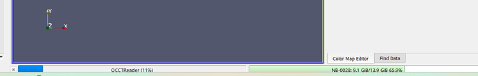

I am using ParaView 5.13.2 and encountering issues when opening STEP files with the STEPReader. The reader shown as OCCTReader gets stuck at a certain loading percentage and remains in this state for a long time. If I attempt to interact with the software during this process, it becomes unresponsive.
Notably, very small STEP files (less than 1MB) can be opened without issues, but larger ones seem to cause this problem. Is there a recommended way to manage or optimize the loading process for STEP files in ParaView?
