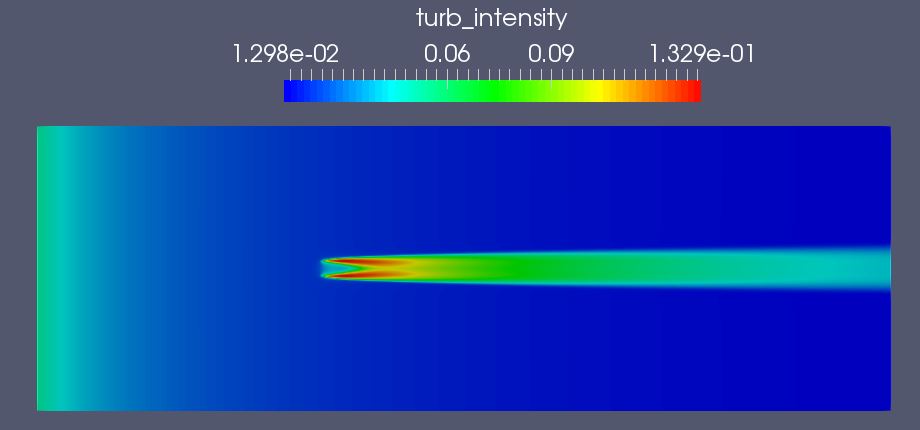

I have a channel flow, I would like to subtract the turbulent intensity at the side wall in the whole domain.
How can I do that with paraview calculator?
I want to the the contour plot of this value
I = Iw^2 - Io^2;
Iw is the total turbulence
I would like to subtract the turbulence intensity
Io is the turbulence at the lateral surface;
I attached figure for clarity

Probably can be done with the python calculator, if not with a ProgrammableFilter

How can I extract the turbulence data along the lateral line (Iamb) in python calculator?
Sorry am a newbie
