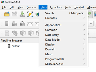

I believe what @jeDuck is referring to is that in 5.13, some of the drop-down menus use different background colors:
For example, the Sources menu has a color of #ffffff
While Filters menu has a background color of #f0f0f0
I think this has been fixed in 6.0 however?

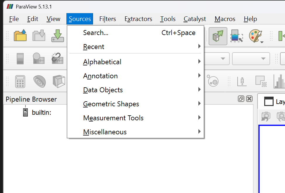

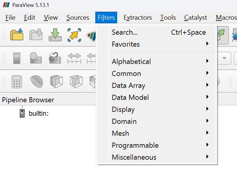

I replicated this issue. It is in 5.13.1, only windows. Mac and Linux don’t show it. It is fixed in 6.0.0.

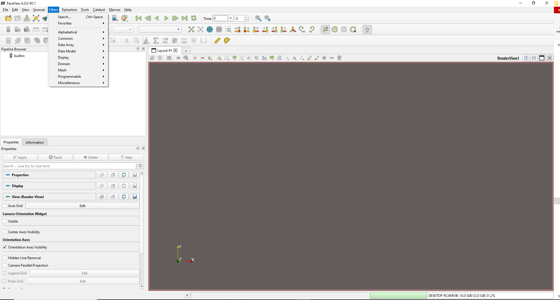

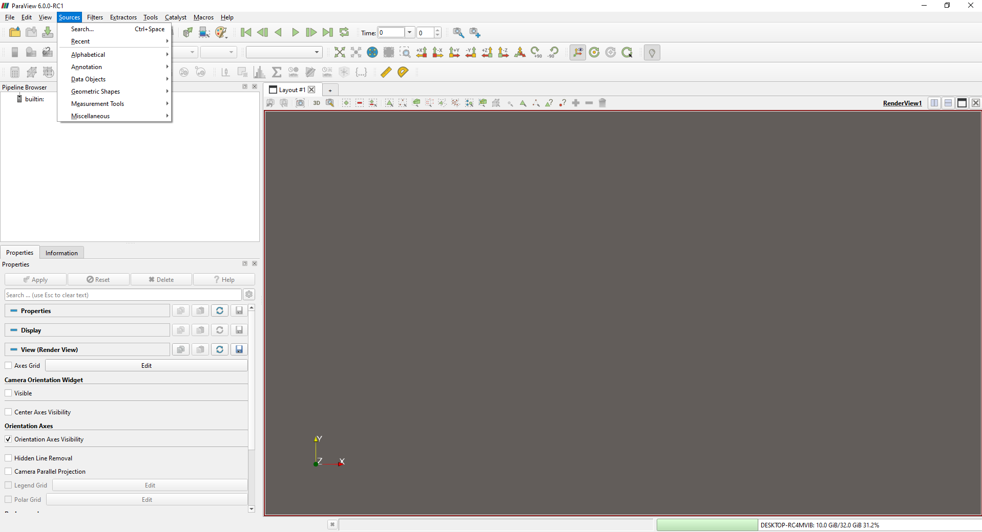

I checked it in Paraview 6.0, windows 10, and the menus still have different color:
  1. Filters menu, color #f0f0f0
  2. Sources menu, color #ffffff

I found the difference. In pqParaViewMenuBuilders the “Filters” and “Extractors” menus call
menu.setStyle(new pqActiveDisabledStyle)
Those two menus are the only ones that are gray.
If you comment this line, the menus become white.
