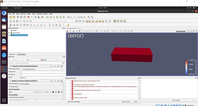

Dear @mwestphal , thanks for your hint. I tried the AnnotateAttributeData and used reservoirfluid::Time as the Input Array but again it raises an error and only (error) pops up in the 3D plot. I have dropped the view here:
You are using ParaView 5.8.1, please update paraview
thanks a lot. It worked with the new version.
