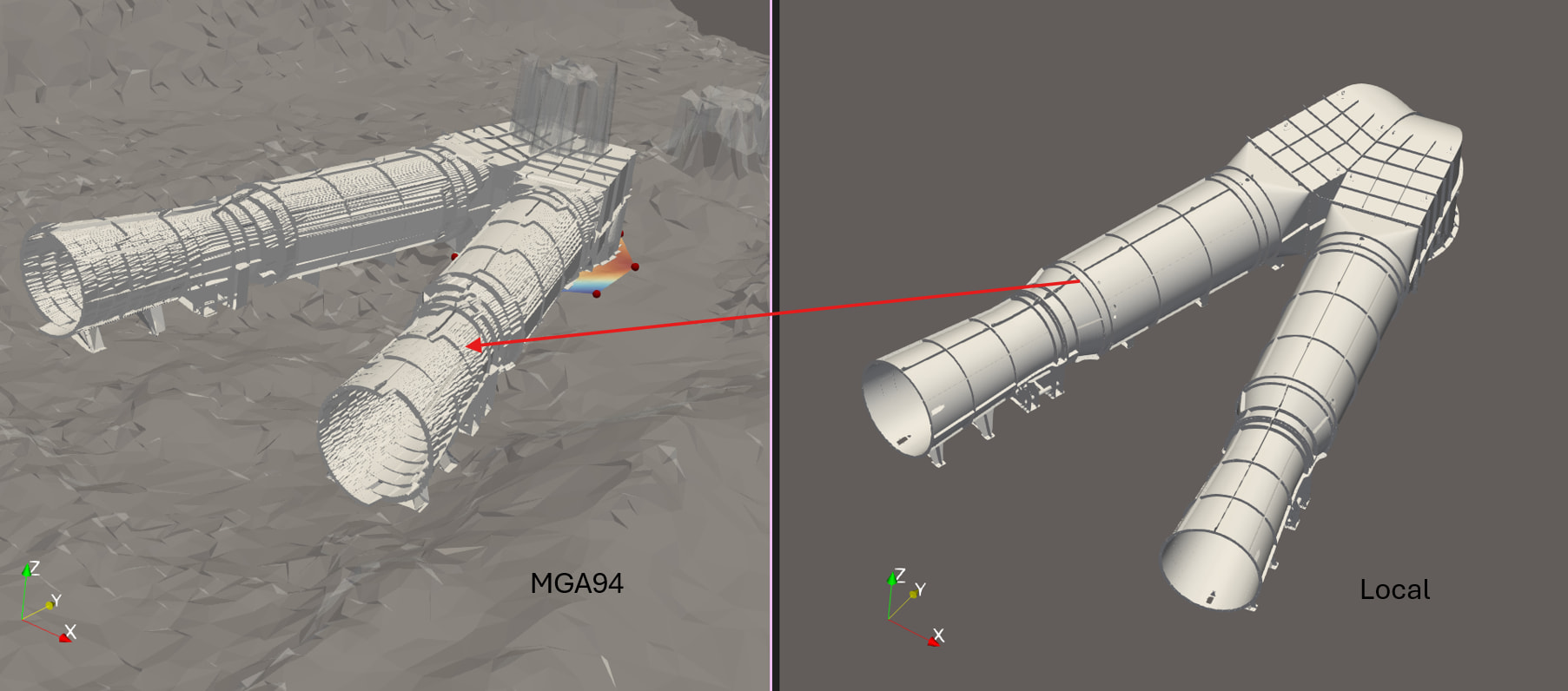

Also, trying a transform just now from local to global I observe the following effect. So there is a visual effect. It’s not desirable though.
Indeed, this can happen when transforming and that why you actually dont want to transform, I mean not in the classical sense.
