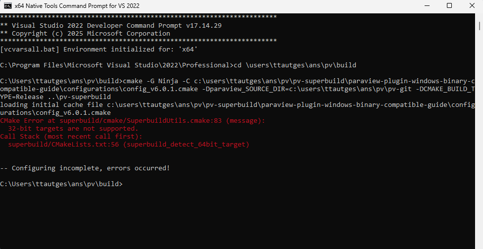

Second subject: instructions for building binary-compatible plugin support fail also. cmake line and result are:
C:\Users\ttautges\ans\pv\build>cmake -G Ninja -C c:\users\ttautges\ans\pv\pv-superbuild\paraview-plugin-windows-binary-compatible-guide\configurations\config_v6.0.1.cmake -Dparaview_SOURCE_DIR=c:\users\ttautges\ans\pv\pv-git -DCMAKE_BUILD_TYPE=Release ..\pv-superbuild

CMake Error at superbuild/cmake/SuperbuildUtils.cmake:83 (message):
  32-bit targets are not supported.
Call Stack (most recent call first):
  superbuild/CMakeLists.txt:56 (superbuild_detect_64bit_target)
-- Configuring incomplete, errors occurred!
Are you building with a 32bit msvc ?
Definitely not supported and not tested. Use 64bit toolchain.
My msvc has both 32 and 64 bit capability installed, cmake is choosing 32 bit for some reason.
Use the “Native x64 MSVC command line tool” to run cmake and cmake --build. You will avoid all issues.
Here is the compilation guide: https://gitlab.kitware.com/paraview/paraview/-/blob/master/Documentation/dev/build.md?ref_type=heads#windows
Good spot, I didn’t realize there was a 64 bit native command tool. But, same result:
Edit: hold on, didn’t clear the cache, maybe that’s it…
Ok, got past that point, so moving forward. Thanks a bunch for the timely help.
