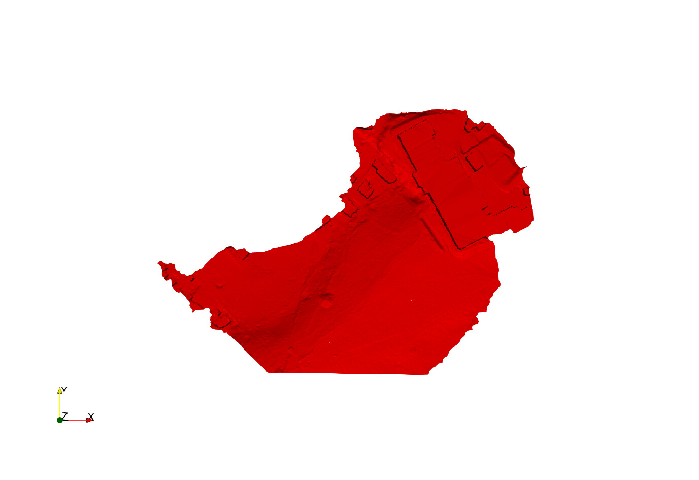

Hi, I have attached the screenshot that gets generated by state513.py
I am operating on Ubuntu 22.04.4 LTS
