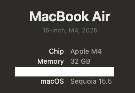

I recently purchased a MacBook with the M4 chip running macOS version 15.3.1. I regularly use ParaView for pre- and post-processing tasks, primarily working with Exodus files. Based on the discussion forums, I learned that the ParaView-5.13.3-MPI-OSX11.0-Python3.10-arm64.dmg version should be compatible with my system.
I was able to install ParaView successfully; however, I’m encountering an issue when trying to open Exodus files—they don’t seem to load properly. These same files work fine on my older Linux machine with a previous version of ParaView, so I’m not sure what might be causing the problem on macOS.

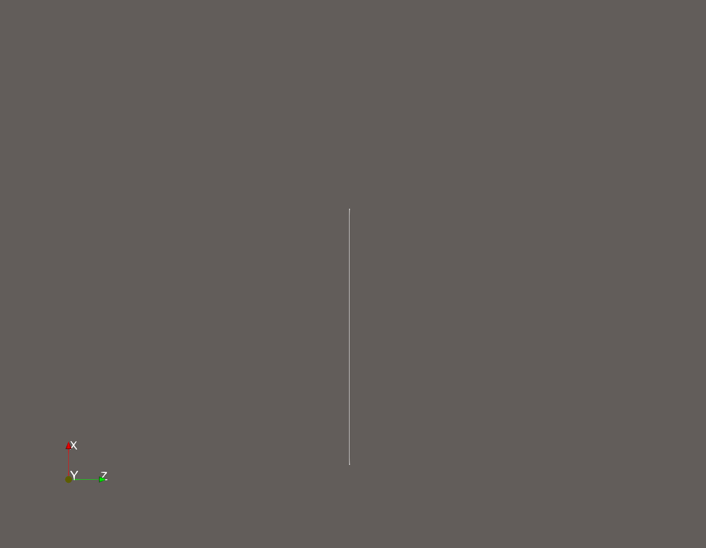

It worked fine in both ParaView 6.0.0-RC1 and 5.13.3.
Are you loading from a network drive? Are you opening the file though the File → Open… menu item or dragging and dropping the file onto the main ParaView window?
Another thing to try is to reset your settings through the Edit → Reset to Default Settings menu item. Choose “Yes, and backup current settings” if you wouldn’t mind sharing the potentially faulty settings file (please post/send ~/.config/ParaView/ParaView5.13.1.ini.bak and /Users/cory.quammen/.config/ParaView/ParaView-UserSettings.json.bak) so we can better understand what might be happening.
Thank you so much for your response. After resetting to the default settings, I was able to successfully load the file. However, I’m still unsure why the error occurred in the first place.
