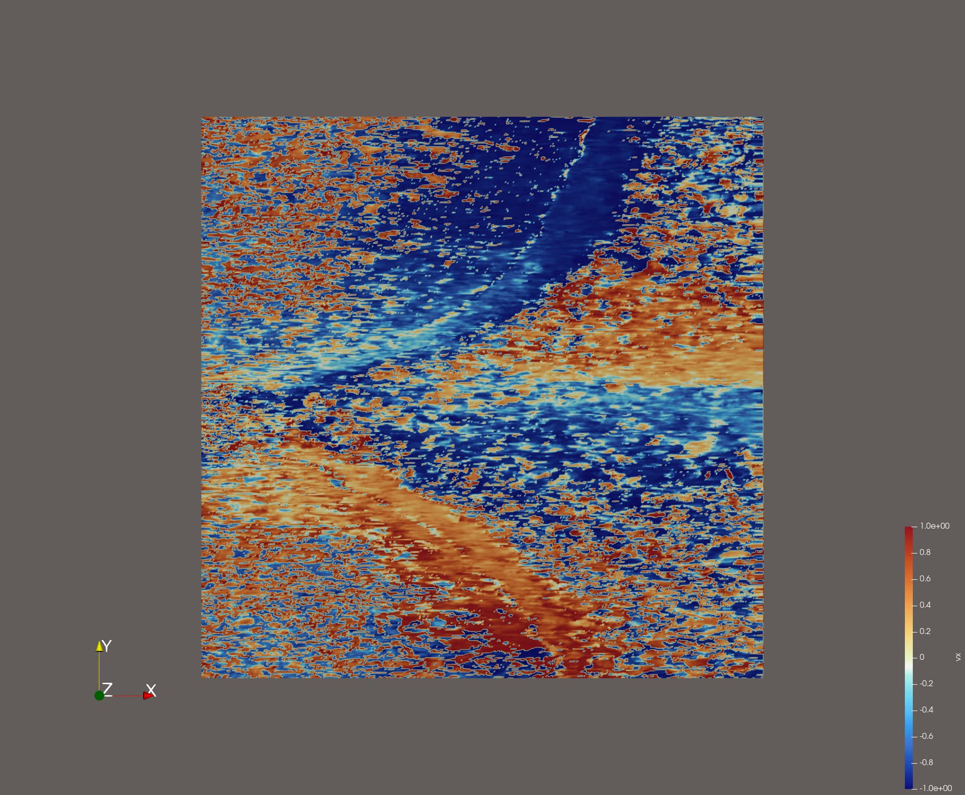

I managed to open your data with both TableToStructuredGrid and TableToPoints but the vector seems incorrect:
TableToPoints:
TableToStructuredGrid:
Here is the state file if that helps:
