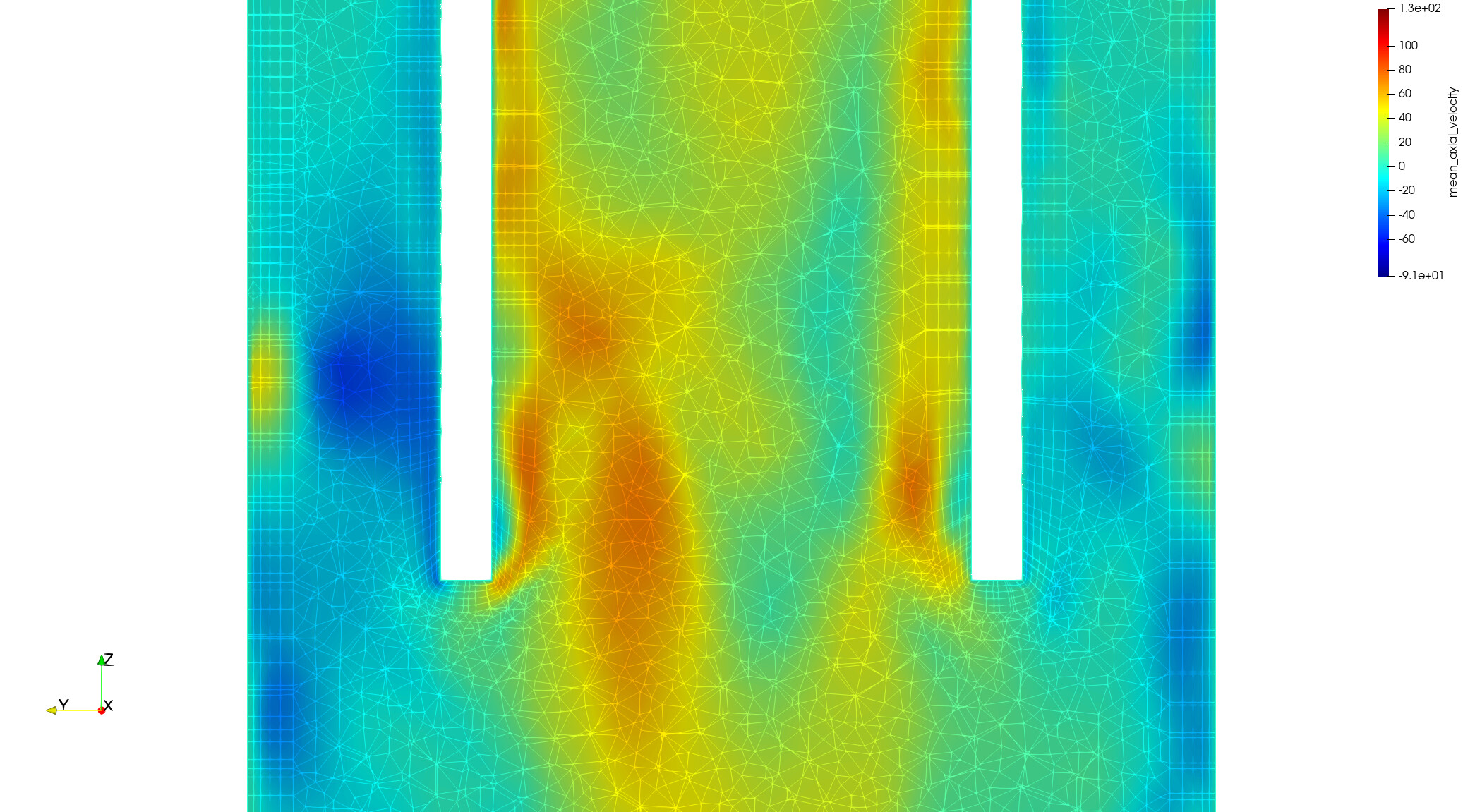

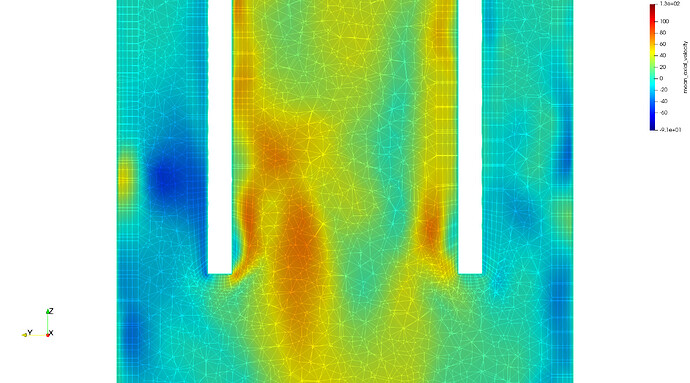

I tried to import ANSYS Fluent solution data in the Encase Gold (ASCII) format into Paraview 6.0.0 RC1. Unfortunately, the resulting visualization included mesh lines. How can I properly visualize the solution data without these mesh lines? Comments and advice are really appreciated.

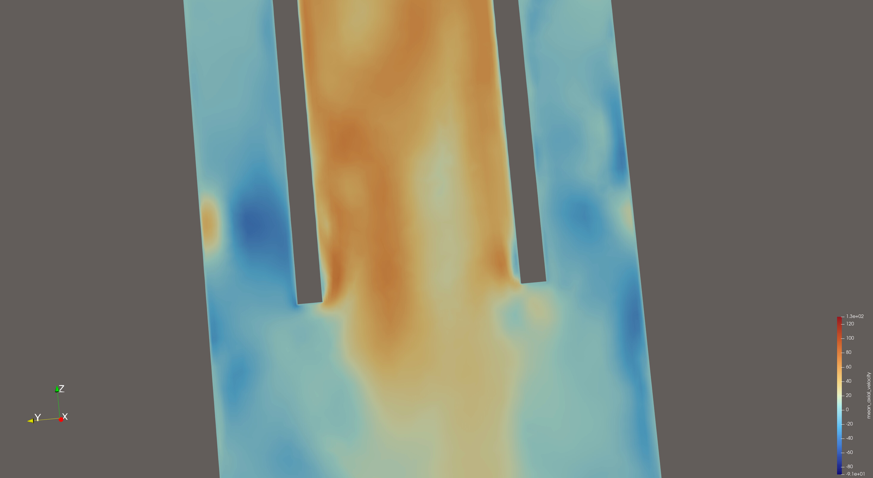

@mwestphal Thank you so much!
This is what I wanted.
