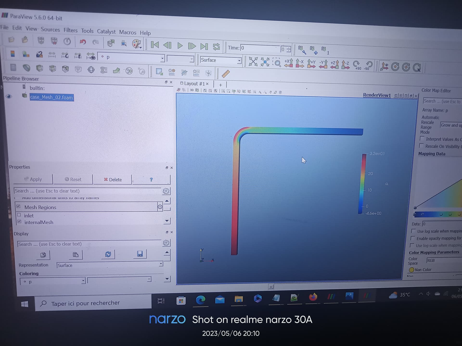

Hello everyone, I am currently working on a project involving a turbulent flow in a bend. I am trying to visualize the vortices in the flow using Paraview, but I am not sure how to proceed. I have heard that the Steamtracer method can be useful for this, but I am not familiar with how to use it. Could anyone please provide some guidance or point me in the direction of relevant resources? Any help would be greatly appreciated. Thank you
Hi @Fatima_Aid
You may look at the documentation: https://docs.paraview.org/en/latest/UsersGuide/filteringData.html#stream-tracer
or watch the streamline webinar: Kitware ParaView Streamlines Webinar - YouTube
Best,
It works, thanks ![]()
