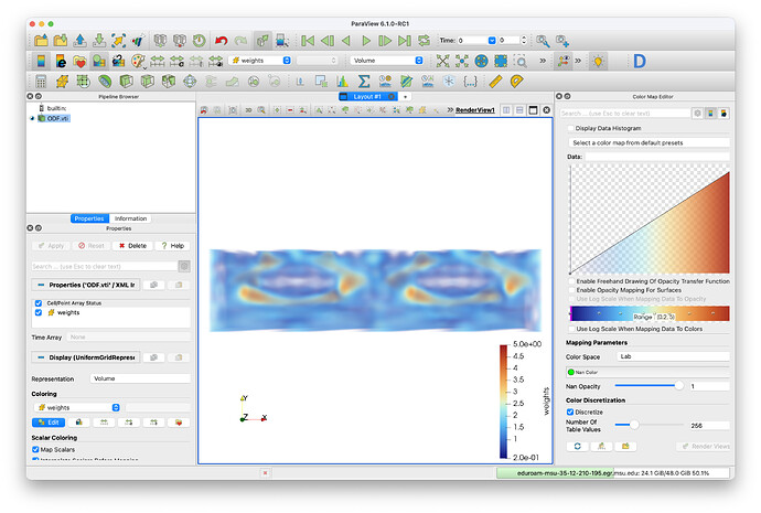

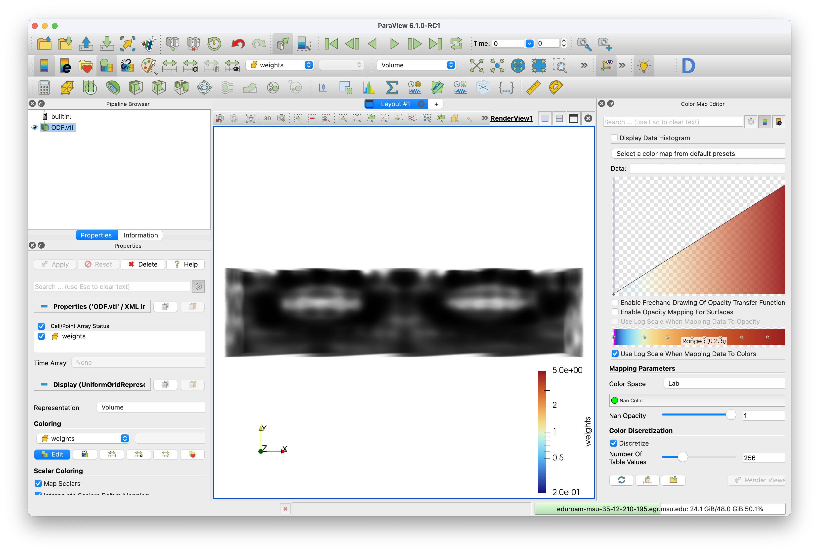

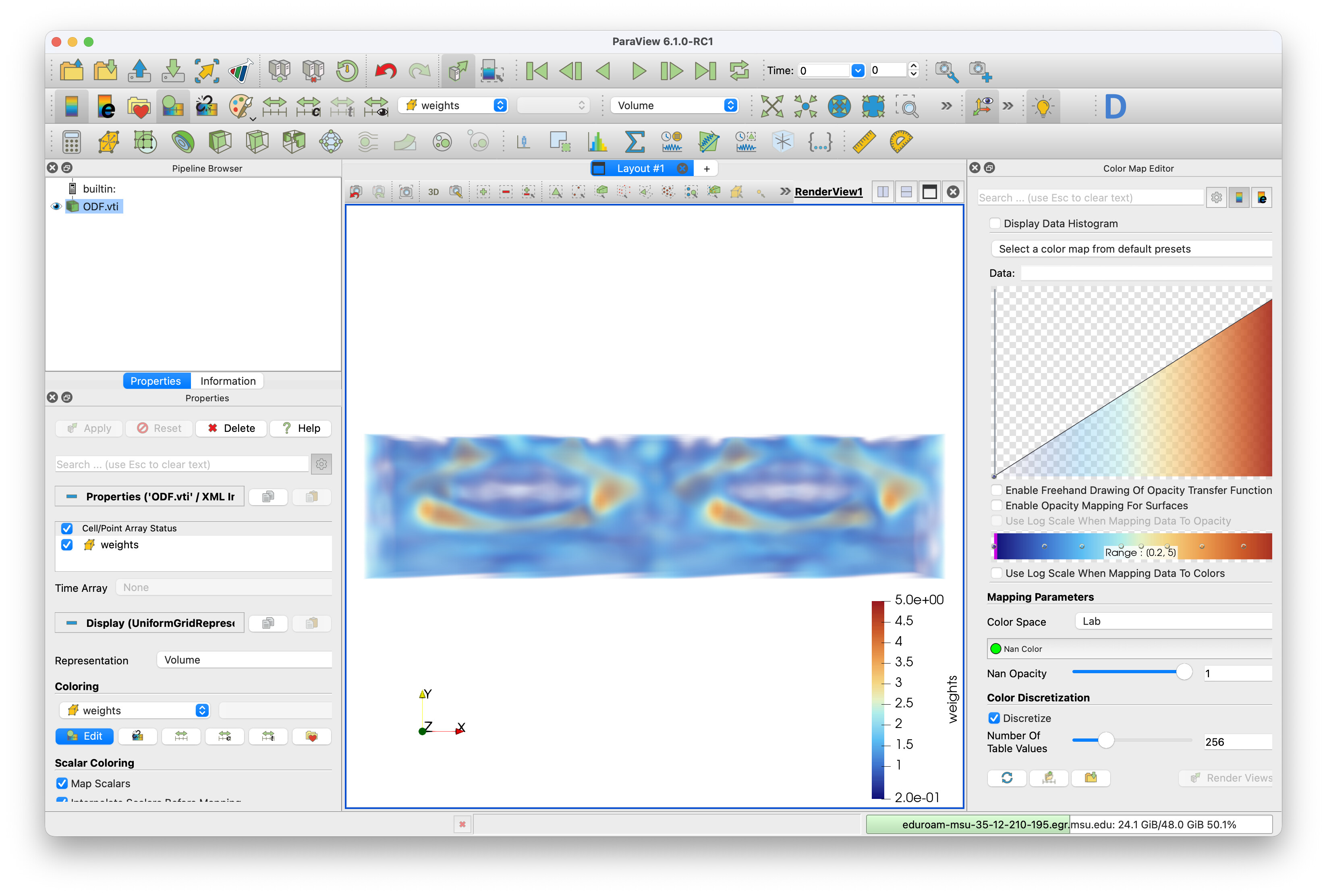

PV 6.1 RC1 inadvertently switches the colormap to grayscale (x-ray) when enabling logarithmic scaling. I use the attached example, switch to volume rendering, set the data limits to 0.2–5, then toggle between linear and logarithmic mapping. The result is shown in the two screen shots…

Confirmed, please open an issue on https://gitlab.kitware.com/paraview/paraview/-/work_items?sort=created_date&state=opened&first_page_size=100
See this in 5.10.1 FYI.
Indeed, old issue
https://gitlab.kitware.com/paraview/paraview/-/work_items/20250
Do you want me to open an issue or does the old one still awaits resolution?
The old ones still awaits resolution, but now we have a reproducer!
