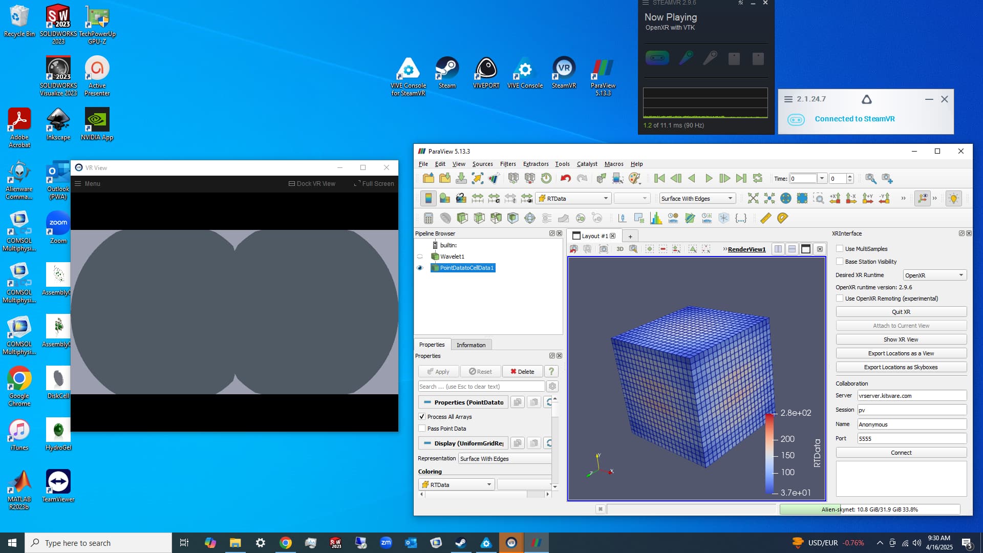

Hello, I am new to VR but not to Paraview. I have been following the webinar (on YouTube) available at this link [Immersive ParaView: AR/VR/XR Exploration with ParaView: A free Kitware webinar]. I am able to create the data (Wavelet and the filter), but I fail to render the screen on my HTC Vive Pro 2. I have installed Steam, SteamVR, VIVEPORT, VIVE Console for SteamVR, and VIVE Console. So far, the computer can recognize the Headset and show the"data transmission," But I can not see anything (but the white screen)… Does anybody run into a similar issue here? Thanks.-
Edit#2: Back in the office, I am uploading a fresh screenshot,
I do not think Vive Pro 2 was tested. Are you able to see steamvr home ? What happens if you use openvr mode instead of openxr ?
Hi Mathieu, thanks for your response. I have tried openvr and I see the same content. Since I can still return the headset and get the refund, what setting are you currently using? I might get the same hardware as yours…
