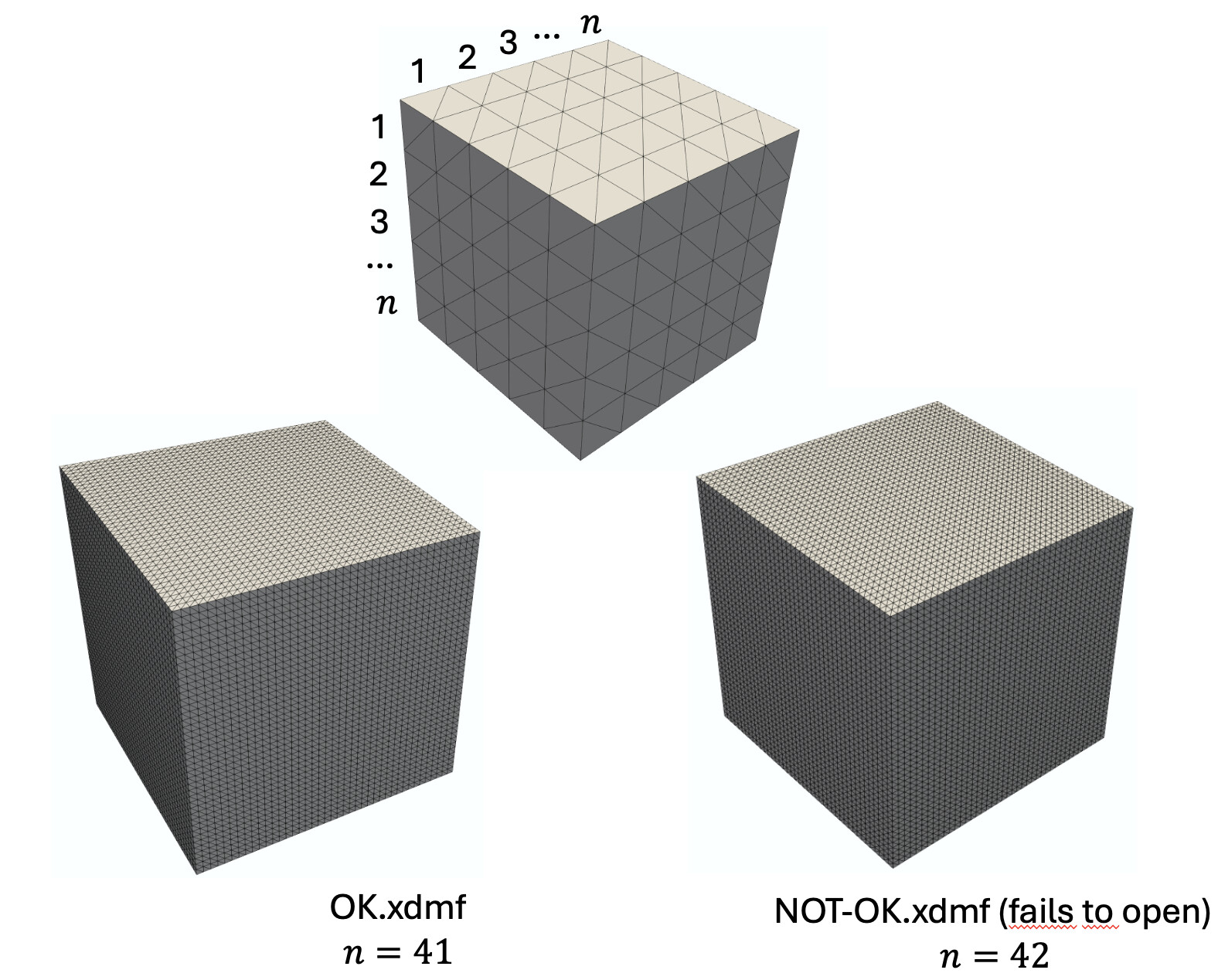

Any updates here? I should have emphasized that the reported issue is a general issue with ASCII-based .xdmf meshes, and not specific to the attached meshes. The below image illustrates the two attached meshes. Both were created using FEniCSx. They just have a slightly different number of elements and there is so obvious reason to me why the larger one fails to open. Any help would be much appreciated.
