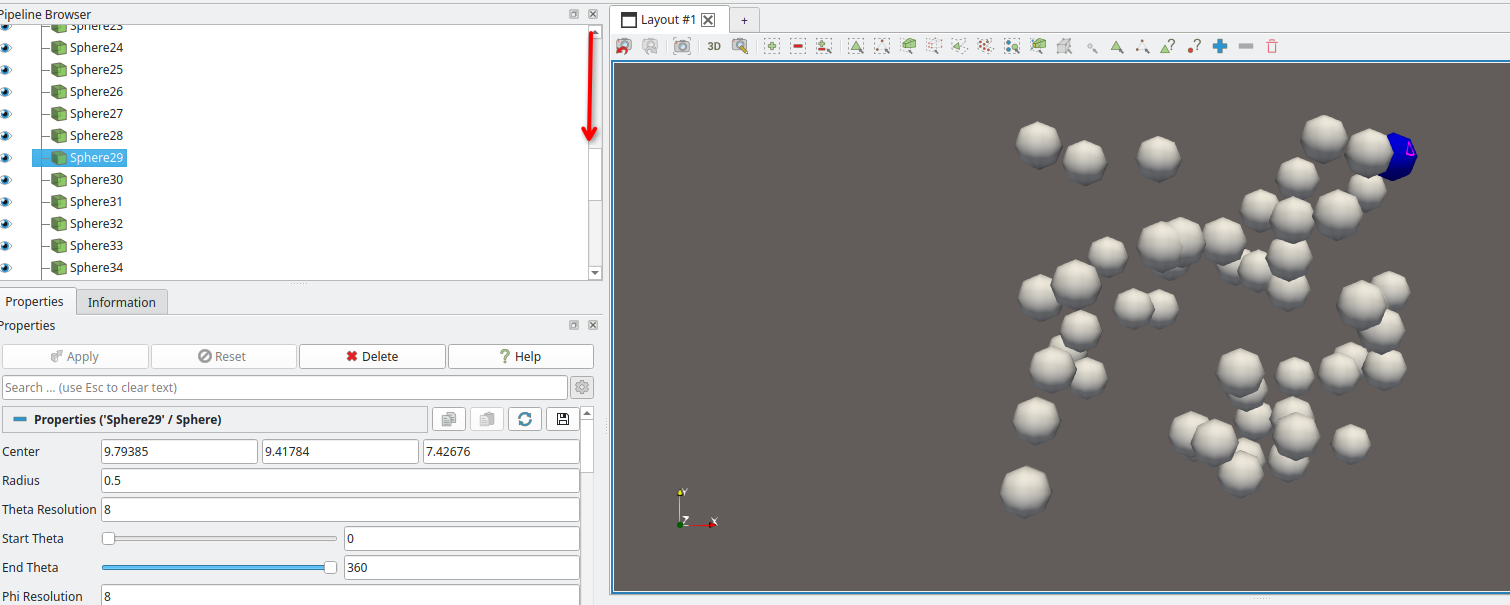

les say, I have a bunch of filters shown in the renderviewr, and i dont know which is which on the pipeline. eg. the blue sphere:
what I currently do, I use select blocks thought hit a random element of the blue sphere as shown, and it will select it on the pipeline browser, so then i can apply lets say transformation to it. aslo i did it intentinally as you can see the sphere i selected is not in the part that i ‘see’ currently on the pipeline, i need to scroll down to find which one it is:
the FR is about, hey not only select it but move the scroll bar automatically so ‘sphere 29’ is on middle of the pipeline elements i can see.
