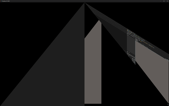

Severe graphical issues in the render view when upgrading to latest 595 NVIDIA driver. Rolled back to 582.16 and both 5.13.3 and 6.1.0-RC1 now work again. Also Optix is not available when using recent driver releases (>582). Running on Lenovo P620 workstation with Windows 11 and RTX A4500.

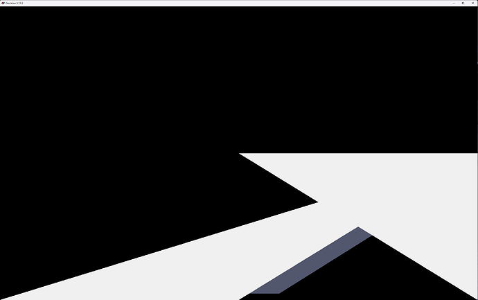

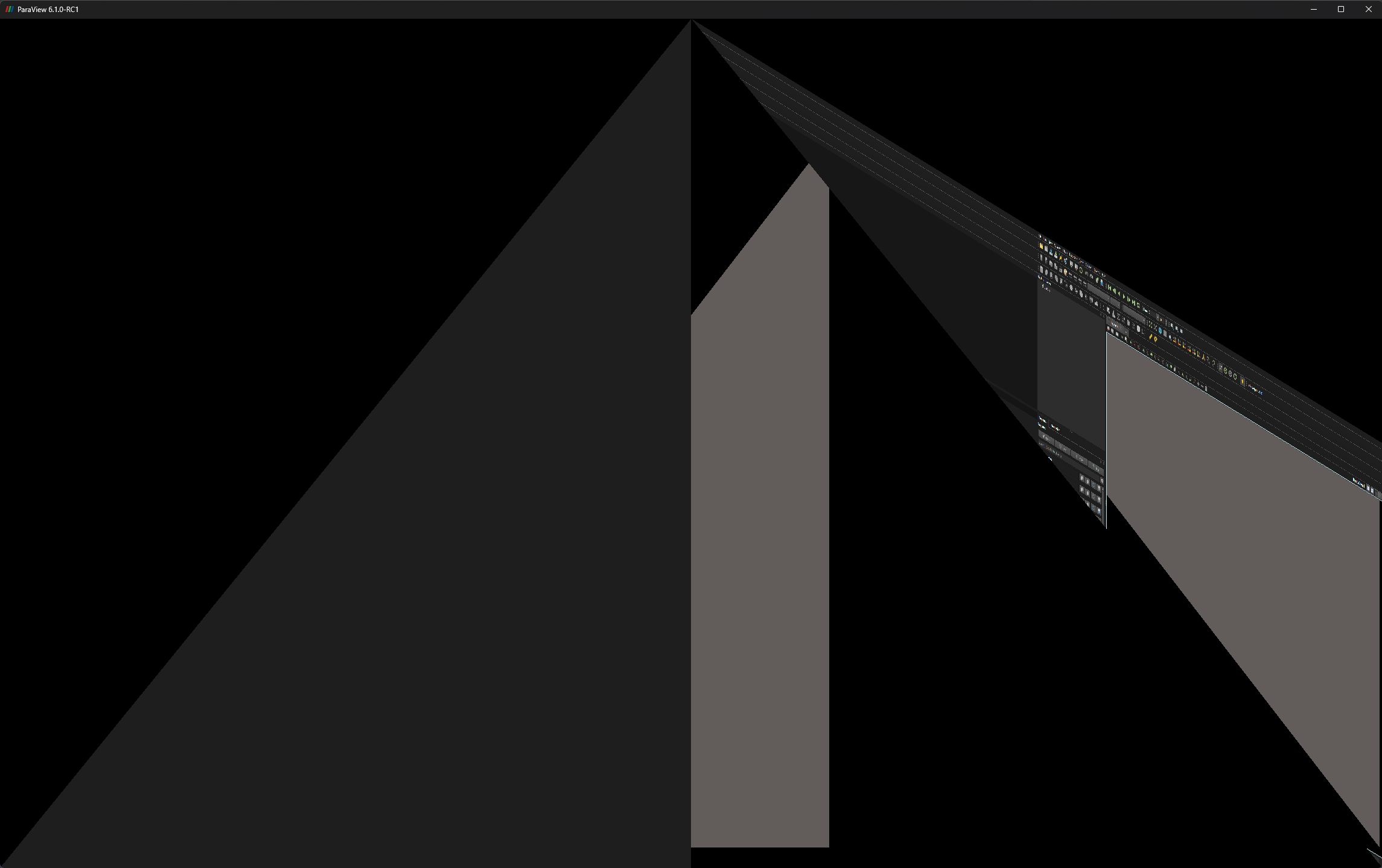

Nope, still the same issue I’m afraid:
So, just to be clear, neither 595.71 or 595.97 are working. And I tried them with both 5.13.3 and 6.1.0-RC1:

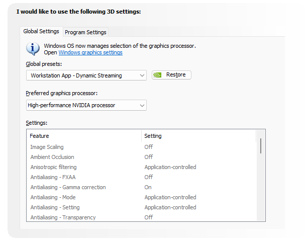

NVIDIA suggests enabling this setting: NVIDIA Control Panel → Mange 3D Settings → Global Preset → Workstation App - Dynamic Streaming
Could you see if that works with the 595 driver?
NVIDIA has confirmation that the workaround resolves the problem, so no need to do this. They want to fix the underlying issue so the workaround is not needed.

By the way this setting doesn’t show up in either NVIDIA Control Panel, or in their Profile Inspector
I found the ā€œDynamic Streamingā€ here:
and it appears to have fixed the problem
