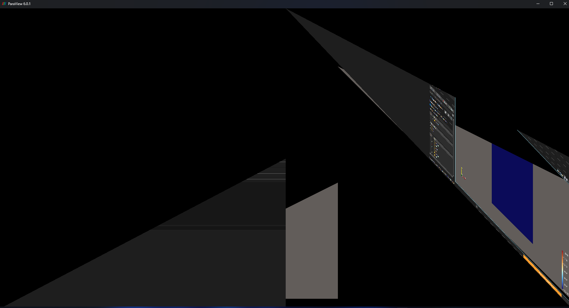

Whenever I open paraview, it opens perfectly, but when I load a file, the screen simply tears or becomes black. It comes back intermittently, but goes black again. I have tried reinstalling the graphics drivers. The desktop has a intel native gpu and an nVidia A1000 gpu. I tried different versions starting 5.6 to 6.1, installation files, or portable versions. None of them seem to work.
We have reports of issues with the latest NVIDIA driver: ParaView not working with NVIDIA driver 595
Rolling back appears to be a good workaround for now.
@uta-dasp did you try rolling back to a previous NVIDIA driver?
