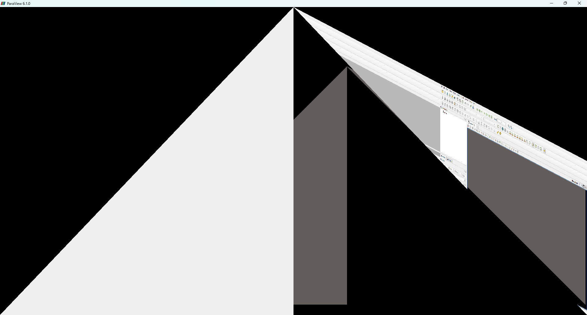

I’ve installed paraview on Windows 11, to use it with cfdOf on freecad.
When I open it, the window of the software is black, and I see the software GUI like I’m looking from it’s side. I know this description is difficult to understand so please check the screenshot below.
I have this issue on Paraview 5.11 installed inside BlueCFD-Core2024, so I remove it and installed the latest Paraview 6.1, but there is the same problem.
What can I do?
Thank you
Hello @rd.airends,
I believe this is the same issue than in this previous post : ParaView not working with NVIDIA driver 595 - #8 by lockan
So it’s not linked to a paraview version but your nvidia driver. AFAIK it has been fixed recently (see ParaView not working with NVIDIA driver 595 - #19 by lockan ) although doing raytracing rendering with Optix seems broken with these recent driver
Many thanks, I’ve installed the latest Nvidia driver and the problem solved
